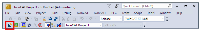

1. Activate the TwinCAT configuration

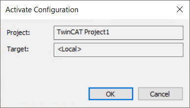

Preparation 1:
A dialog box appears.

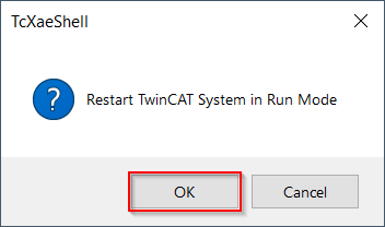

Preparation 2:
2. Confirm with OK

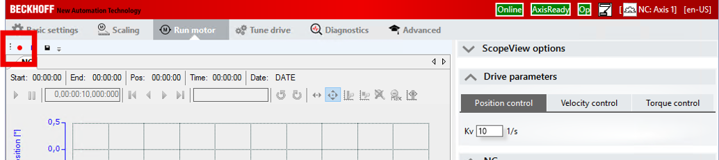

8. Click on the button "Start record"
Preparation 5:
The Scope View records position, speed and following error.
