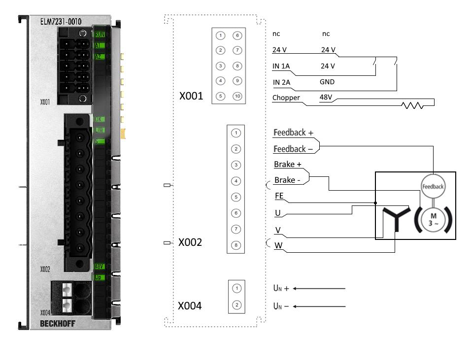

ELM7231 1:
X001
Connection
Pin
Function
ELM7231 2:
1
n.c.
2
24 V
24 V UP Voltage output
3
IN 1A
Fast digital input 1 for a Touch Probe (limit switch)
4
IN 2A
Fast digital input 2 for a Touch Probe (limit switch)
5
Chopper
Connection for a passive braking resistor.
Connect the other connection cable of the braking resistor to pin 10.
6
n.c.
7
24 V
8
24 V
9
GND
Ground
10
DC+
Connect the other connection cable of the braking resistor to pin 5.
X002
Connection
Pin
Function
ELM7231 3:
1
Feedback+
OCT data cable
2
Feedback-
OCT data cable
3
Brake+
Output for the motor brake
4
Brake-
5
FE
Functional earth
6
U
Motor phase U
7
V
Motor phase V
8
W
Motor phase W
X004
Connection
Pin
Function
ELM7231 4:
1
DC+
DC link voltage input
2
GND
Ground
