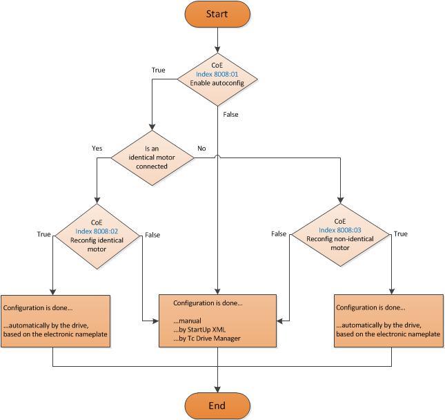

The AM8100 series servomotors from Beckhoff have an electronic identification plate. The technical data of the motor and the feedback system are stored in the electronic identification plate.
The ELM72xx can read the electronic identification plate via the OCT data lines. The technical data are automatically written to the corresponding parameters of ELM72xx during this process.
- If you use the Drive Manager 2, the electronic identification plate is read out automatically.
- If you do not use the Drive Manager 2, you can configure the reading of the electronic identification plate according to the following flow chart:
