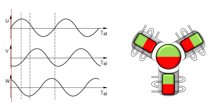

The servomotor is an electrical motor. Together with a servo amplifier the servomotor forms a servo drive. The servomotor is operated in a closed control loop with position, torque or speed control.
The terminals ELM72xx support control of permanent magnet synchronous motors. These consist of 3 coils which are offset by 120° and a permanent magnet rotor.
Servomotors particularly demonstrate their advantages in highly dynamic and precise positioning applications:
- very high positioning accuracy in applications where maximum precision is required through integrated position feedback
- high efficiency and high acceleration capacity
- servomotors are overload-proof and therefore have far greater dynamics than stepper motors, for example.
- load-independent high torque right up to the higher speed ranges
- maintenance requirements reduced to a minimum
