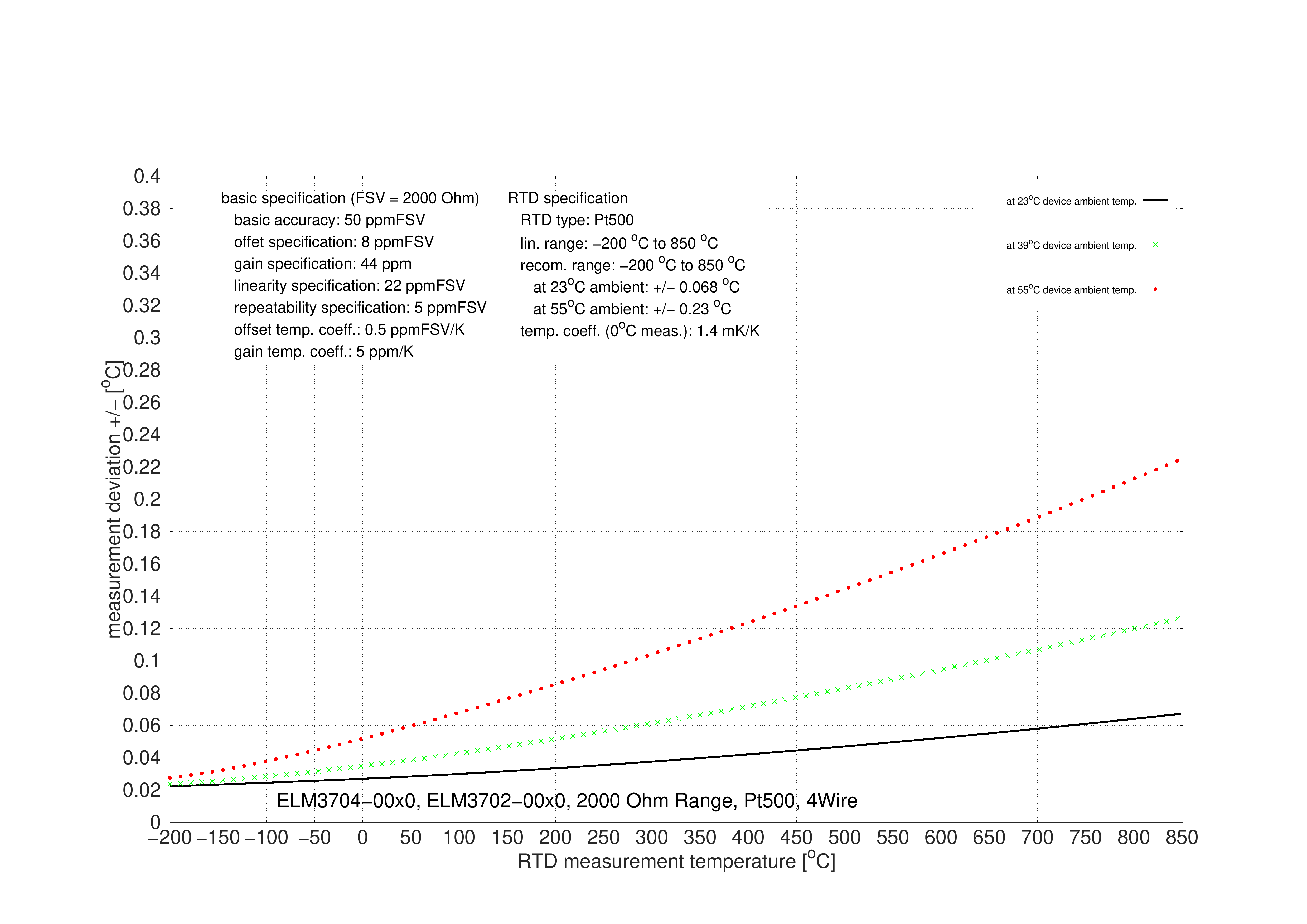

Measurement uncertainty for Pt500 in the electr. measuring range 2000 Ω, 4-wire connection:
PT500 specification 1:

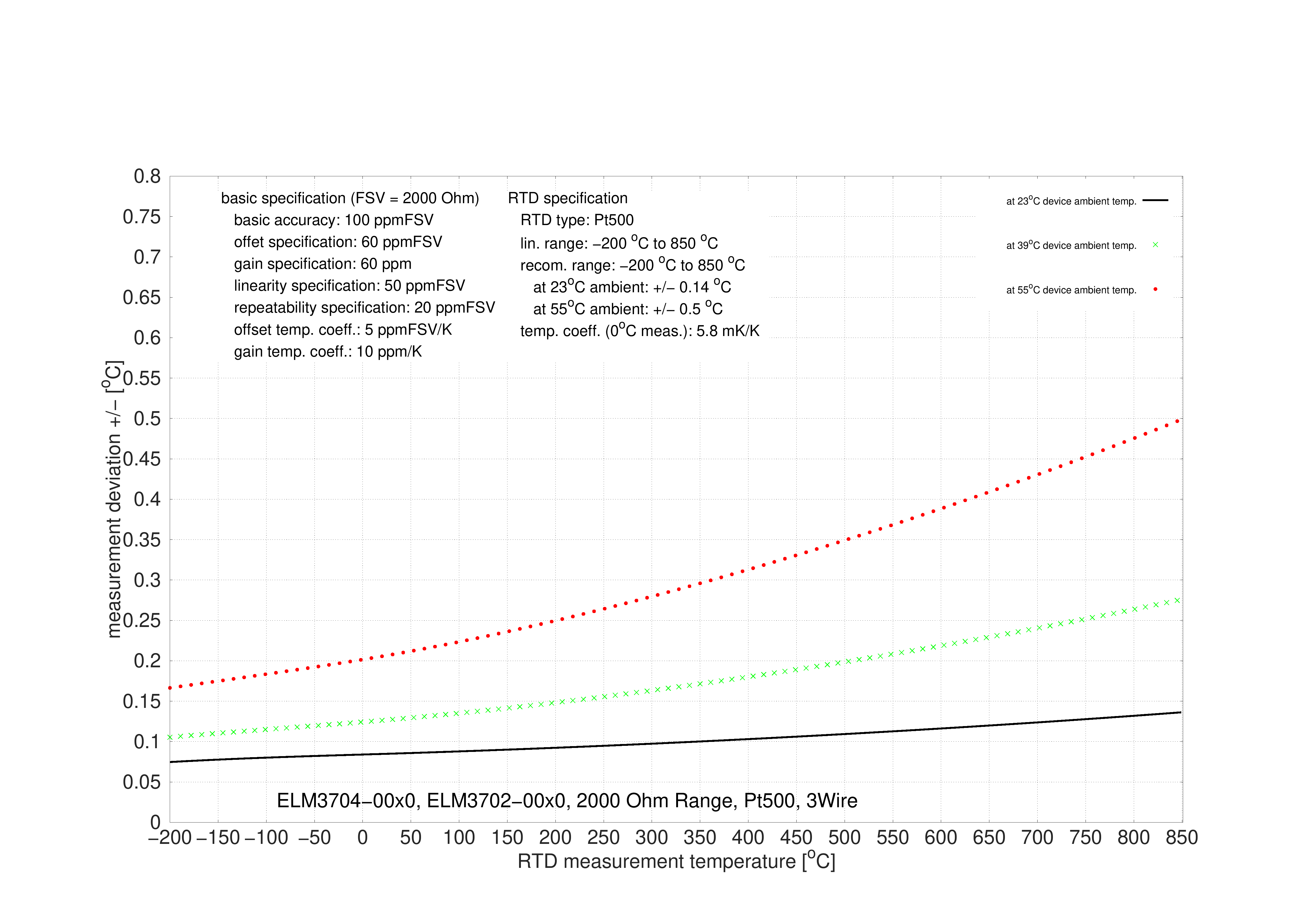

Measurement uncertainty for Pt500 in the electr. measuring range 2000 Ω, 3-wire connection:
PT500 specification 2:

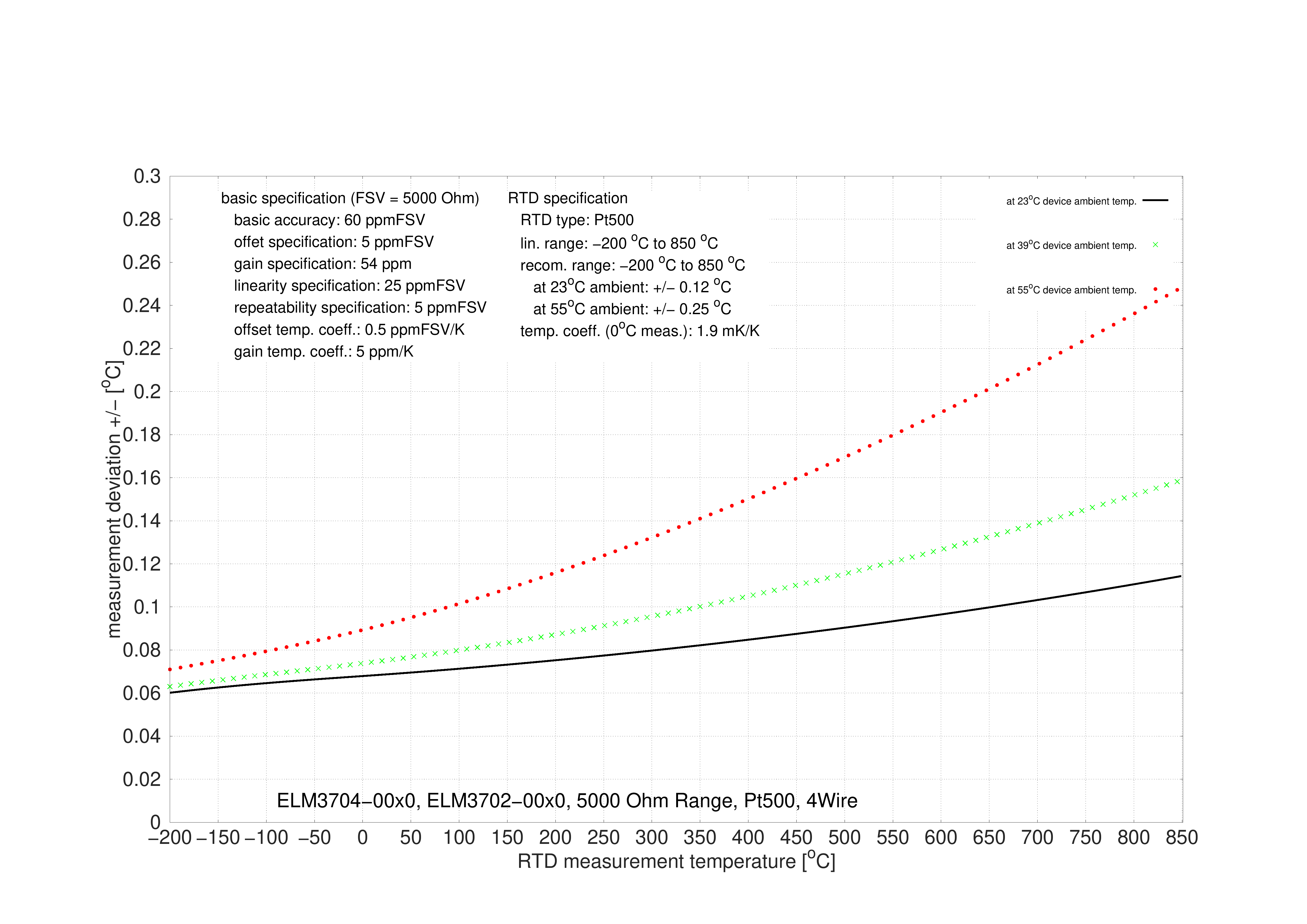

Measurement uncertainty for Pt500 in the electr. measuring range 5000 Ω, 4-wire connection:
PT500 specification 3:

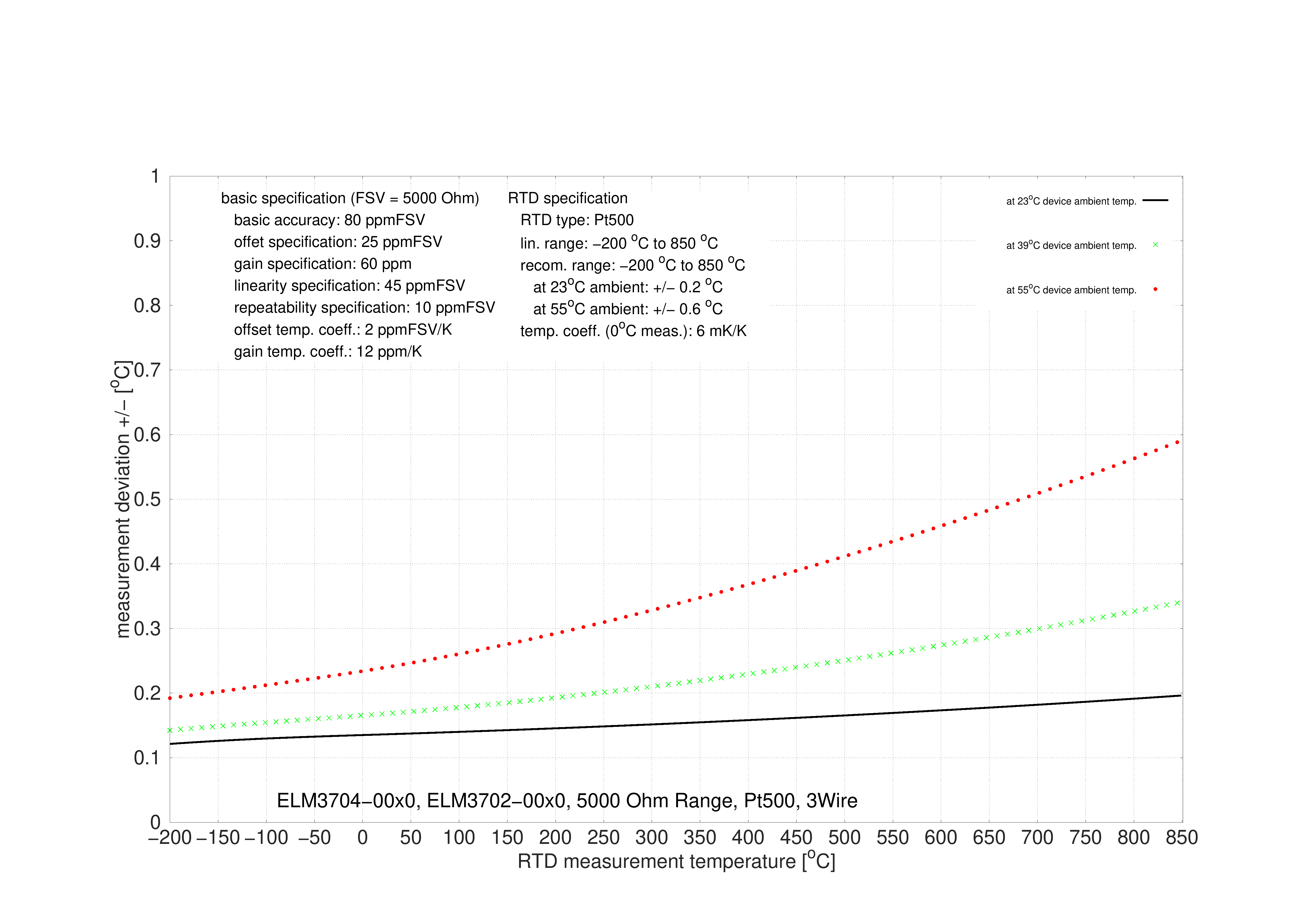

Measurement uncertainty for Pt500 in the electr. measuring range 5000 Ω, 3-wire connection:
PT500 specification 4:
