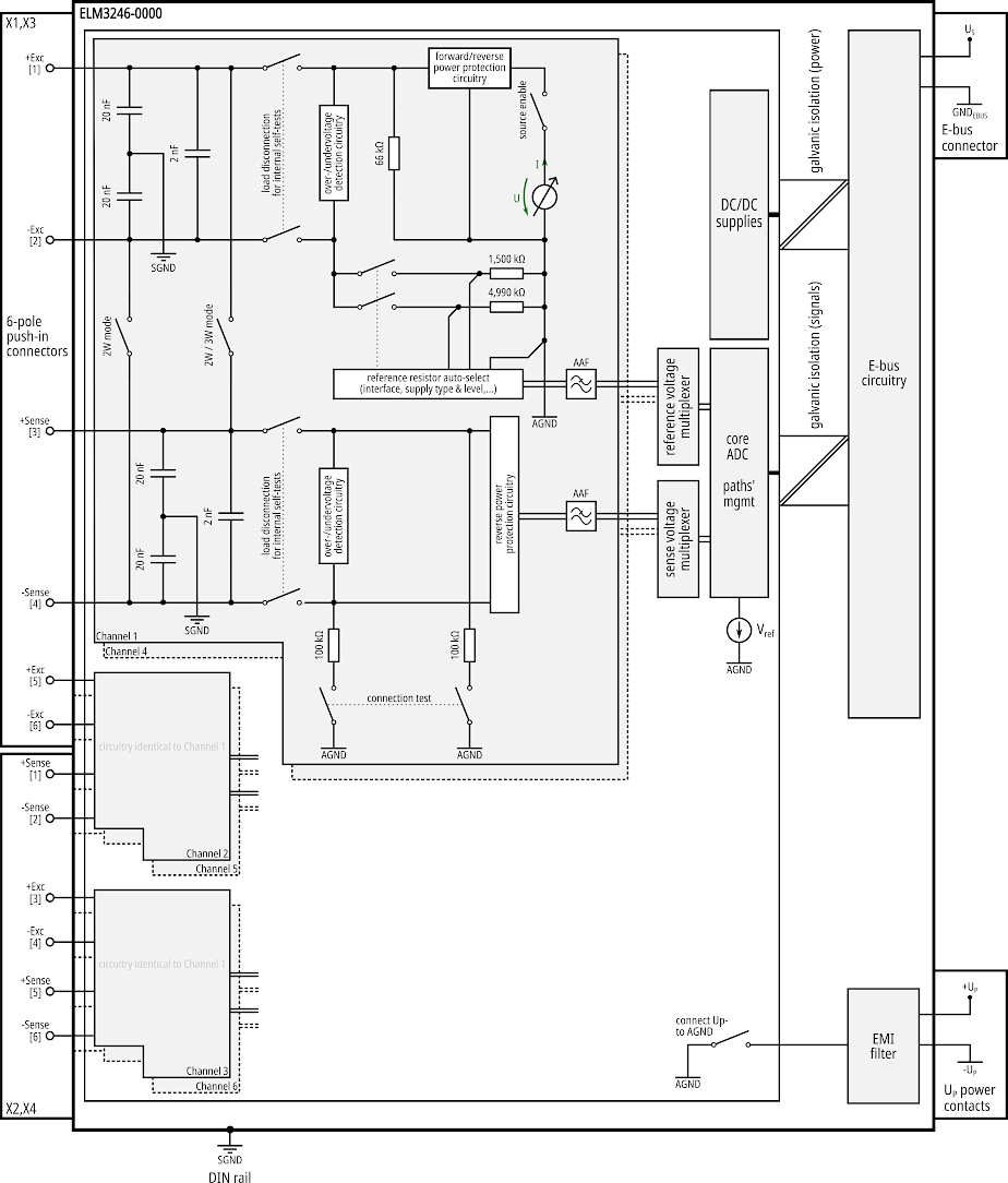

Power supply, potential groups 11:
Fig.256: Potentials schematics ELM3246-0000
