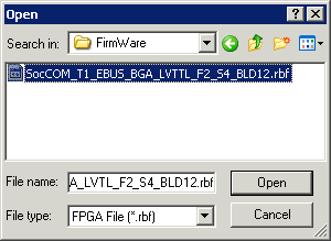

- Select the file (*.rbf) with the new FPGA firmware, and transfer it to the EtherCAT device:
