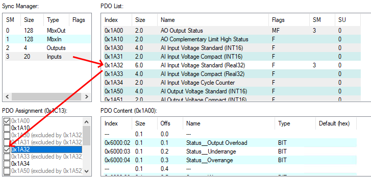

All analog channels (AO and AI) of the terminal are available 4-fold (alternatively!) in the process image for mapping/activation:
Example AI Output Voltage:
- in 2 representations
- as REAL32-FloatingPoint PDO (to be used preferably, saves consideration of the FSV)(default)
- alternatively as INT16 (FSVresp.range= x7FFF) for compatibility with any existing programs
- and 2 data sizes
- Default: value + status (default)
- Compact: value only
The PDO mapping can be used in the SyncManager, a TwinCAT Activate
and reload is necessary afterwards
