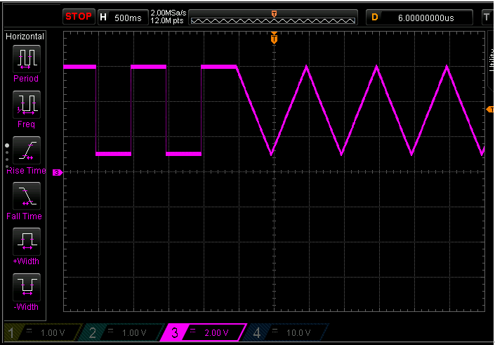

Example: A rectangular output of 1 V / 6 V from the PLC is converted to a triangular output by "Output Slew Rate" = 1 s (corresponds to 10 V/s):
Slew Rate 1:Fig.241: Triangle output by reshaping
