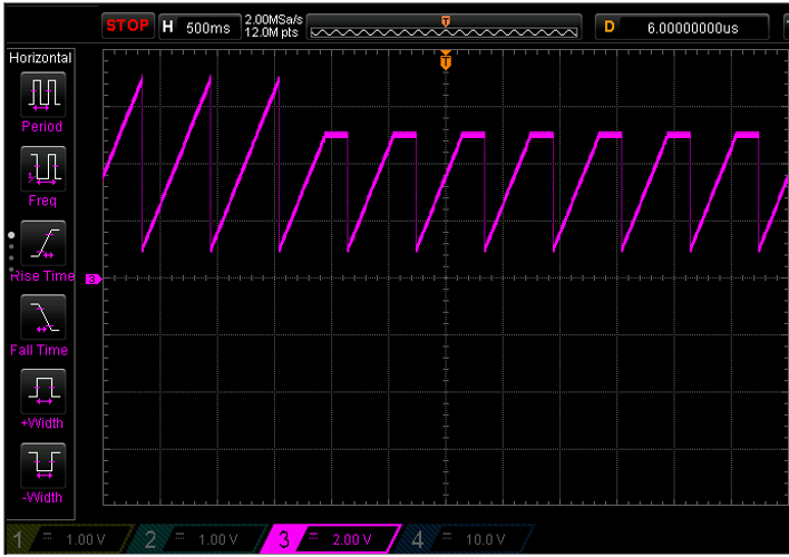

Example: Sawtooth 1..7 V is output and then a "Limiter High Value" of 5 V is set:
Fig.238: Index 0x80nD set to 5 V
Fig.239: Sawtooth outputThe overrange is counted accordingly below:
Fig.240: Counter overrangeNote:
