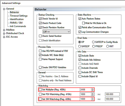

Setting the watchdog time
The watchdog time, i.e. the time at which the watchdog case is triggered, is set via the general TwinCAT dialog "Advanced Settings" -> General -> Behavior -> Watchdog -> "Set Multiplier" and "SM Watchdog" (SM = SyncManager).
![]() | Notes on settings
Fig.231: Watchdog settings, here: 100 msWatchdog time [ms] = Multiplier * SM Watchdog [ms]
A maximum watchdog time of 65 s is possible. Larger values are calculated modulo 65, for example 70 s would be shortened to 5 s.
Notice | ||
![]() | General notes on watchdog settings Observe the general notes on the watchdog settings. | |

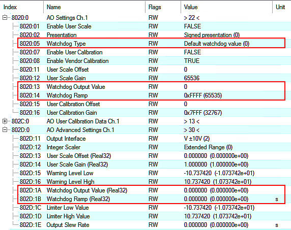

Setting the watchdog behavior
The following settings can be made for the watchdog, starting from index 0x80n0:05 "Watchdog Type":
Fig.232: Selection "Watchdog Type"
Fig.233: Indices for watchdog settingsValues Index 0x80nD, | Meaning |
Default watchdog value (default) | The analog output value is set without transition to the user-specific substitute value/setpoint according to index 0x80n0:13 or index 0x80nD:1A (default: 0) |
Watchdog Ramp | Likewise, substitute value/setpoint according to index 0x80n0:13 or index 0x80nD:1B, but linear ramp to that point. The gradient of the ramp must be specified in relation to AEWnom
If, for example, a gradient of 2 V/sec is required with AEWnom = 10 V, the "Watchdog Ramp (Real32)" = 5 [sec] or (with "Extended Range" -> 327 µV/digit) "Watchdog Ramp" = 6 [digit/ms]. Default value: 0 (no ramp) |
Last Output value | Last output value remains |
