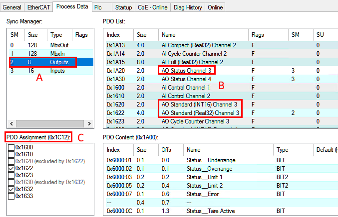

Process data configuration
The PDOs that can be used for this output channel (A) are described in TwinCAT in the PDO list (B):
Process data configuration 1:Fig.218: Tab "Process data"
The desired PDOs can be enabled in (C), exclusions are displayed.
Each channel can be set to one of the above-mentioned process data formats, e.g. 0x1622 must be enabled for Real32 transmission on channel 1 and the control PDO 0x1621 can be added.
Alternatively, the suggested data sets can be selected from the Predefined PDO list:

This list summarizes frequently used PDO compositions for convenient choice. It should be noted that these then affect all channels at the same time.
During the PDO changeover, other functional units in the data flow may be reset to the default setting!
Therefore, the PDO decision must be made at the beginning; a change requires an ActivateConfiguration.
