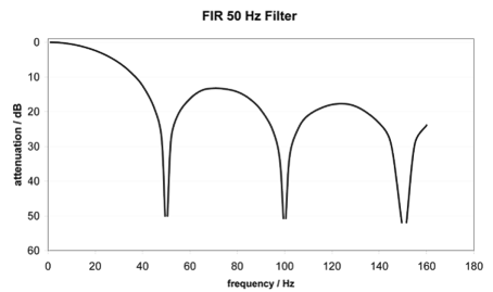

Filter 1 (low-pass) 3:Fig.185: FIR 50 Hz filter
Filter data FIR:
Filter
Attenuation
Cut-off frequency (-3 dB)
Conversion time
Sampling rate
50 Hz FIR
>50 dB
22 Hz
625 µs
1600 sps
60 Hz FIR
>45 dB
26 Hz
521 µs
1920 sps

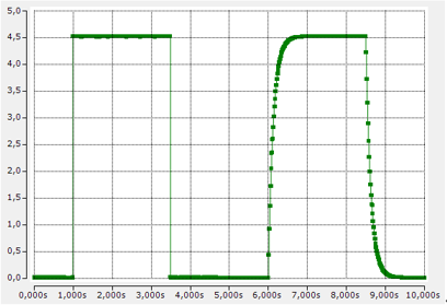

Filter 1 (low-pass) 4:Fig.186: Comparison of square wave signal 0.2 Hz/4.5 V, EtherCAT cycle time 100 µs, left filter disabled, right IIR8
