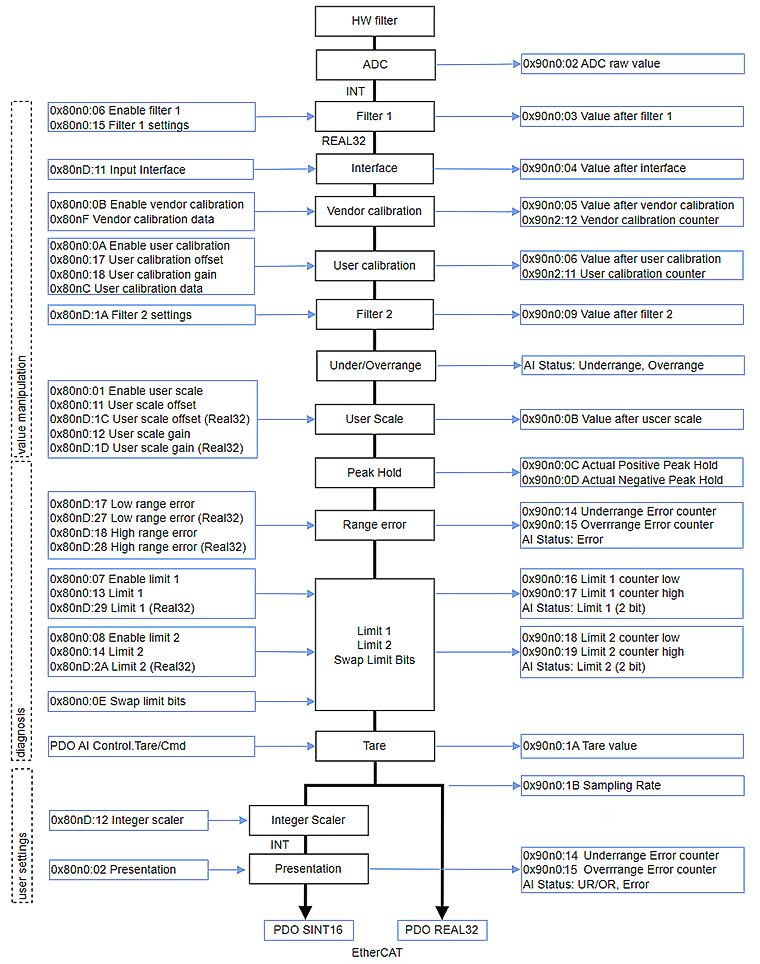

Data flow AI (Analog Input)
The signal acquisition and data processing of the analog input of this device is as follows:
Data flow AI (Analog Input) 1:
Fig.51: Data flow of the analog input
Data flow diagram legend

This terminal only uses floating point calculations internally, as shown in the data flow. This considerably simplifies and shortens the commissioning of the analog channel, which minimizes errors in understanding. In addition, intermediate values along the data calculation can be easily displayed in the CoE.
The Real32 and INT16 values are defined in the CoE without units. However, the unit is determined by the context and should, wherever possible, be regarded as an SI unit. For example, the voltage is measured in V, the current in A (even with 20 mA input!), the resistance in ohms and the ratio in V/V....

Commissioning of the analog input in TwinCAT should follow this data flow and is described below.
