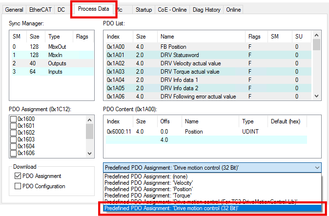

Since the terminal provides 64-bit process data by default, but this cannot be processed by some controllers, there is also the alternative option of mapping the process image with 32 bits. This can be set via the Predefined PDO Assignment "Drive motion control (32-bit)".
(To map the inputs and outputs manually, use the 0x1641 and 0x1A41 indices. See chapter Process data.)

Configuration
- 1. In the CoE parameter 0x7010:03 "Modes of operation" set the operation mode "Drive Motion Control (DMC)".
- 2. Activate the Predefined PDO Assignment "Drive motion control (32 Bit)".
- The process data for using Drive Motion Control is activated.
