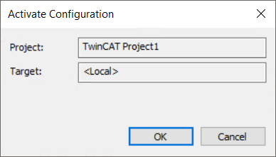

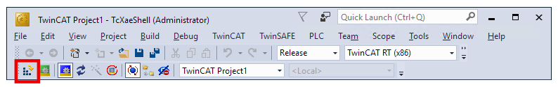

1. Activate the TwinCAT configuration
Preparation 1:
A dialog box appears.

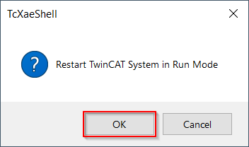

Preparation 2:
2. Confirm with OK
