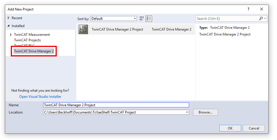

- 1. Select the menu item File > Add > New Project in TwinCAT
- A dialog box opens.
- 2. Select “Installed” > “TwinCAT Drive Manager 2” in the dialog box on the left-hand side and click on OK

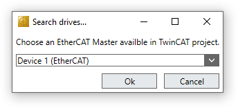

- If the TwinCAT project contains several EtherCAT masters, the following dialog box appears:
Choose the EtherCAT master to which the EL7062 is connected - A dialog box opens.

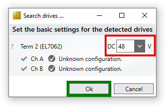

- 3. Set the motor supply in the dialog box and click on "OK".
- The project was created.
- The EL7062 was integrated into the project.
