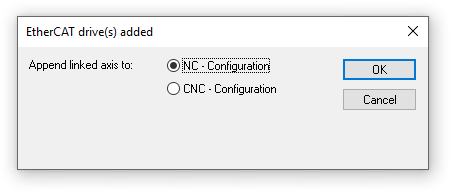

In the course of the integration, a dialog box appears:
Integrating into a TwinCAT project 1:
2. Select “NC - Configuration” and click on “OK”

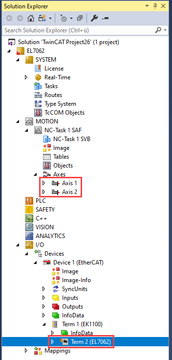

The EL7062 is integrated into the I/O configuration and the NC configuration of your TwinCAT project
Integrating into a TwinCAT project 2:
