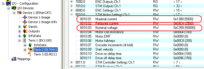

Settings in CoE register
Adaptation of current and voltage
Notice
The motor may overheat!
In order to prevent overheating of the connected motor it is important to adapt the current and voltage output from the stepper interface to the motor.
To this end set the index 0x8010:01 "Maximum current" and 0x8010:03 "Nominal voltage" in the CoE register to suitable values (see Fig. Adaptation of current and voltage).
Reduced current can be set in index 0x8010:02. This reduces the coil current when at a standstill (and therefore the power dissipation). Please note that the torque is also reduced.
Settings in CoE register 1:Fig.151: Adaptation of current and voltage

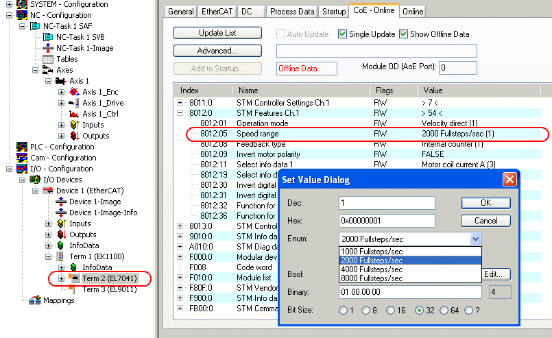

Base frequency selection
Microstepping is set to 1/64 and cannot be changed. However, the base frequency can be changed (default: 2000). To this end select the terminal and select the CoE Online tab. Change the base frequency by double-clicking on the index 0x8012:05 "Speed range" (Fig. Setting the base frequency).
Settings in CoE register 2:Fig.152: Setting the base frequency
