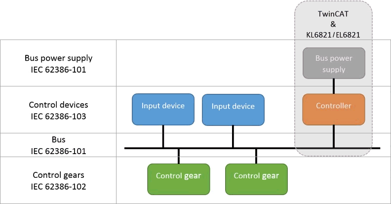

The IEC 62386-101, IEC 62386-102 and IEC 62386-103 standards describe general properties, while the IEC 62386-2xx and IEC 62386-3xx standards specify the individual device types. IEC 62386-103 and IEC 62386-3xx were included in Revision 2 of the DALI standard.
IEC 62386 1:
Up to 64 DALI control gears and up to 64 DALI control devices can be connected to the KL6821/EL6821 per DALI line. The KL6821/EL6821 represents the DALI controller. One such device exists for each DALI line. Up to 64 control gears, which have to be DALI/DSI devices, can be connected to the KL6811. Any number of DALI lines (KL6811, KL6821 or EL6821) can be operated with a single TwinCAT controller.
