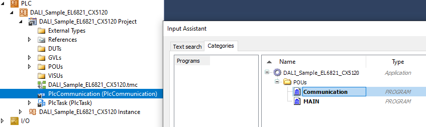

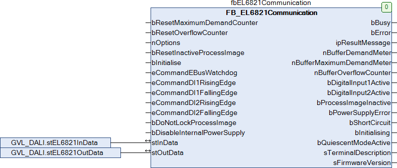

Create a program (CFC) for the background communication with the DALI terminal. The function block FB_EL6821Communication is called in the program. In the communication block ensure that the structures stInData and stOutData are linked.

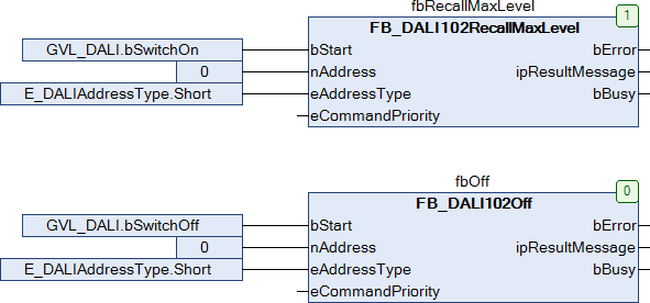

Create a MAIN program (CFC) in which the function blocks FB_DALI102RecallMaxLevel and FB_DALI102Off are declared as follows.
PROGRAM MAIN
fb102RecallMaxLevel : FB_DALI102RecallMaxLevel(Communication.fbEL6821Communication);
fb102Off : FB_DALI102Off(Communication.fbEL6821Communication);
END_VARThe communication block is specified in the round brackets after the declaration. The reference to the desired DALI terminal is defined via this specification.
For more information, see Transfer of the reference to the communication block.
Call the two instances of the function blocks FB_DALI102RecallMaxLevel and FB_DALI102Off with the following variables.
The input bStart of the function block for switching on a lamp with the maximum output value is linked to the global variable bSwitchOn.
The input bStart of the function block for switching off a lamp is linked to the global variable bSwitchOff.

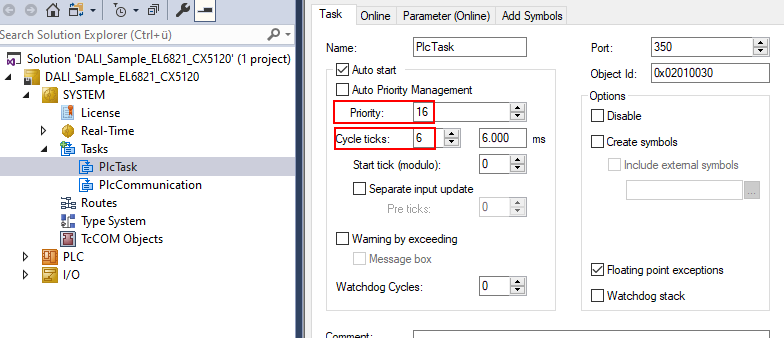

Navigate to the task configuration section and configure the PlcTask. By way of example, the task is assigned priority 16 and a cycle time of 6 ms.

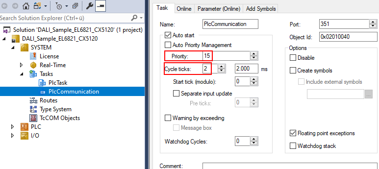

Create another task for background communication. Give this task a higher priority (lower number) and a lower interval time than the Plc task.
Add the program for the communication to this task. Further information on task configuration can be found in the description of the function block FB_EL6821Communication.

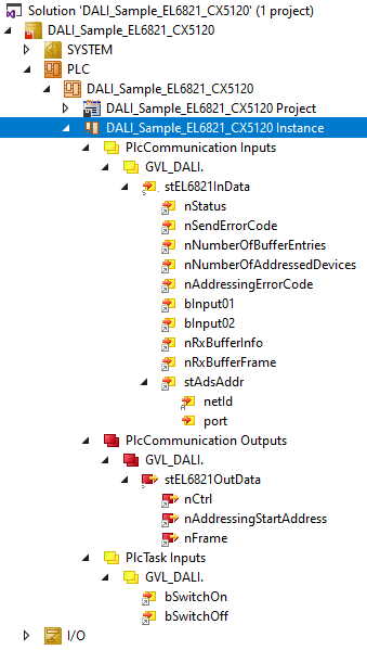

Select the CX as target system and initiate a search for its hardware.
In the instance (DALI_Sample_EL6821_CX5120 Instance) of the PLC project, you can see that the input and output variables of the PLC program are assigned to the corresponding tasks (PlcCommunication and PlcTask).
Now link the global variables of PLC program with the inputs and outputs of the bus terminals. Create the Solution and enable the configuration.
The lamp with the maximum brightness value is switched on by pressing the first push button. The second push button can be used to switch it off again.
