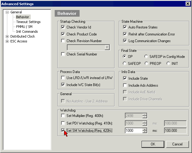

Their times are parameterized individually in TwinCAT as follows:
Fig.5: EtherCAT tab -> Advanced Settings -> Behavior --> Watchdog Remarks:
- The Multiplier register 400h (hexadecimal, i.e. 0x0400) is valid for both watchdogs.
- Each watchdog has its own timer setting 410h or 420h, which together with the multiplier results in a time.
- Important: the multiplier/timer setting is only loaded into the slave at EtherCAT start if the checkbox in front of it is activated.
If this is not activated, nothing is downloaded and the setting in the ESC remains unchanged. - The downloaded values can be viewed in the ESC registers 400h, 410h and 420h: ESC Access -> Memory (ESC Access -> Memory).
