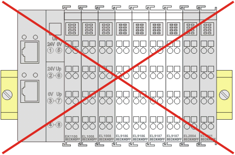

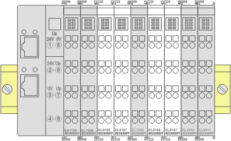

To ensure an optimal data transfer, you must not directly string together more than two passive terminals!
Examples for positioning of passive terminals (highlighted)
Positioning of passive Terminals 2:Fig.12: Correct positioning
Positioning of passive Terminals 3:Fig.13: Incorrect positioning
