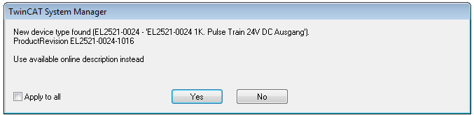

If the EtherCAT configuration is created online through scanning of real devices (see section Online setup) and no ESI descriptions are available for a slave (specified by name and revision) that was found, the System Manager asks whether the description stored in the device should be used. In any case, the System Manager needs this information for setting up the cyclic and acyclic communication with the slave correctly.

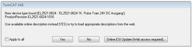

In TwinCAT 3 a similar window appears, which also offers the Web update:
If possible, the Yes is to be rejected and the required ESI is to be requested from the device manufacturer. After installation of the XML/XSD file the configuration process should be repeated.

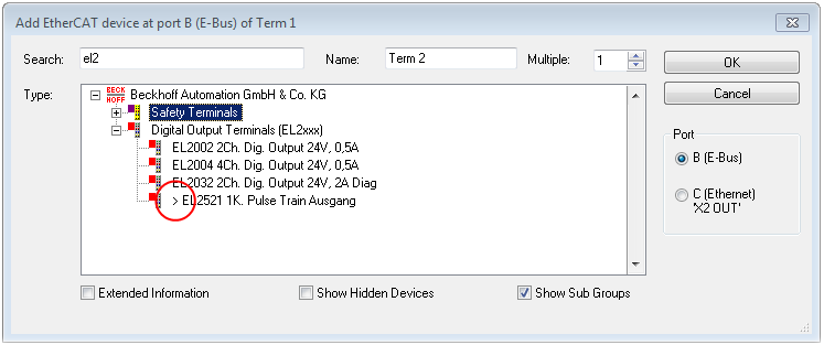

Is a slave desired to be added manually to the configuration at a later stage, online created slaves are indicated by a prepended symbol “>” in the selection list (see Figure Indication of an online recorded ESI of EL2521 as an example).

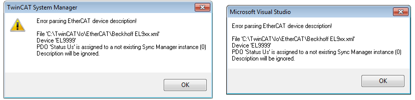

If an ESI file is faulty and the System Manager is unable to read it, the System Manager brings up an information window.
Reasons may include:
- Structure of the *.xml does not correspond to the associated *.xsd file → check your schematics
 - Contents cannot be translated into a device description → contact the file manufacturer
