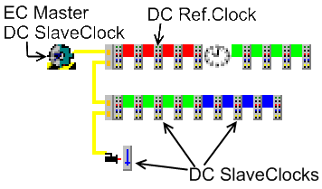

Fig.13: Mapping of DC to the topologyIn Fig. Mapping of DC to the topology the 3rd EtherCAT slave was selected as DC reference clock as an example. The local time of this slave is now used to adjust all other distributed clocks, i.e. all other EtherCAT slaves and the clock of the EtherCAT master. This is achieved through synchronization datagrams, which the EtherCAT master sends cyclically.
![]() | TwinCAT clock readjustment The TwinCAT clock that determines the real-time must track the DC ReferenceClock to ensure that the PLC/NC tasks in the real-time context of the controller run synchronous with the distributed clocks. If more than one EtherCAT system is used on a control system, only one of these systems can provide the ReferenceClock for TwinCAT. The other EtherCAT systems in turn must then follow the TwinCAT clock. |
This procedure ensures that all devices supporting DC always have local access to a time that is identical (within the DC synchronization accuracy) in all devices.
