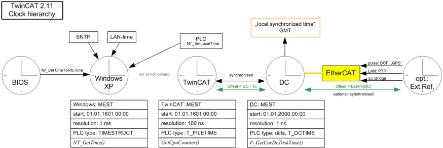

TwinCAT clock hierarchy
Concept for external TwinCAT synchronization 2:Fig.15: TwinCAT 2.11 clock hierarchy (subject to change)
The CE operating system uses a different system time. Using the DC clock is therefore recommended.
Basic principles
If EtherCAT components are used for external synchronization of TwinCAT, a time is provided for the local controller that matches the higher-level time. As the fieldbus, EtherCAT makes the necessary operating resources available, in particular EtherCAT’s own synchronization mechanism, distributed clocks. In other words,

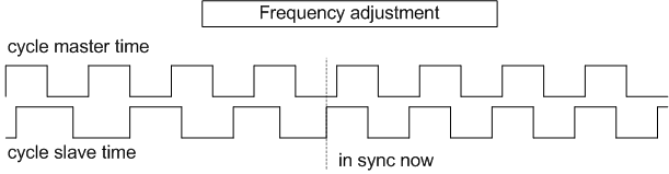

The procedure is as follows:
Concept for external TwinCAT synchronization 3:Fig.16: Frequency synchronicity
Note the following:

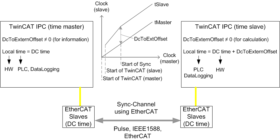

Concept for external TwinCAT synchronization 4:Fig.17: Synchronization of 2 TwinCAT IPCs with the aid of EtherCAT components
Concept for external TwinCAT synchronization 5:
Using the synchronized time
In the adjusted station the "other" time from the master PC is known through:
Synchronized DC time = local DC time + offset
This synchronized time can now be used for data logging. The local DC time must still be used for tasks related to the respective station hardware (EtherCAT slaves, terminals).

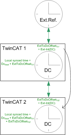

Cascading of synchronized TwinCAT systems
We advise against cascading of several time-synchronized TwinCAT systems. However, please note that simple cascading already occurs if a TwinCAT system is controlled by an external clock based on GPS and transfers its local time to a subordinate EtherCAT system via an EL6692 bridge terminal.
In the subordinate systems the respective DcToExt offset relative to the higher-level systems must be taken into account.
Synchronized DC time = local DC time + DcToExtOffset local + Σ DcToExtOffset higher-level
The respective higher-level DcToExtOffsets can be transported through network variables, ADS, via the EL6692 bridge terminal or any other channels. The subordinate system must take these offsets into account.
Concept for external TwinCAT synchronization 6:Fig.18: Cascade consisting of controlled TwinCAT systems
