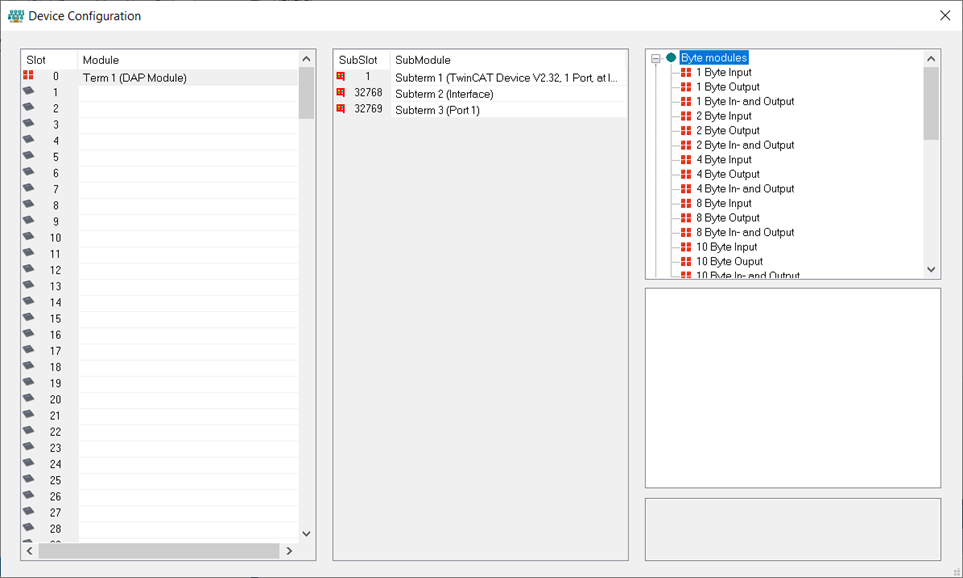

With TwinCAT Version 4024, the classic tree view for module/submodule population was replaced by a rack view.
In this view slots can be populated and removed without shifting the following slots. Empty slots can remain free and do not have to be provided with placeholders.

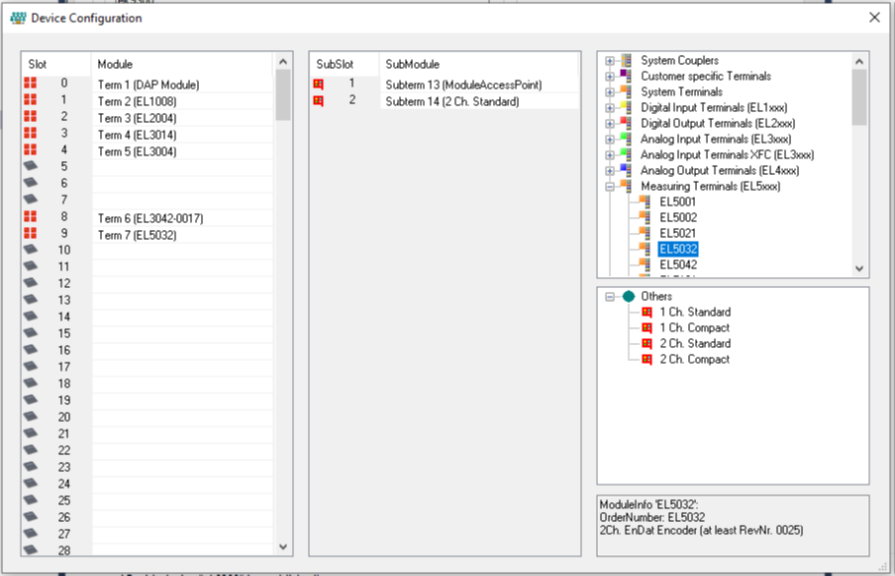

The list on the left shows the available device slots; here you can see which slots are occupied or free. Clicking on a slot updates the list in the center, showing the available subslots at the selected slot. If supported by the module, the submodules can then be populated here.
From TwinCAT Version 3.1 Build 4024 2:
The list on the right shows the available modules and submodules. The list of submodules is always updated depending on the selected module.

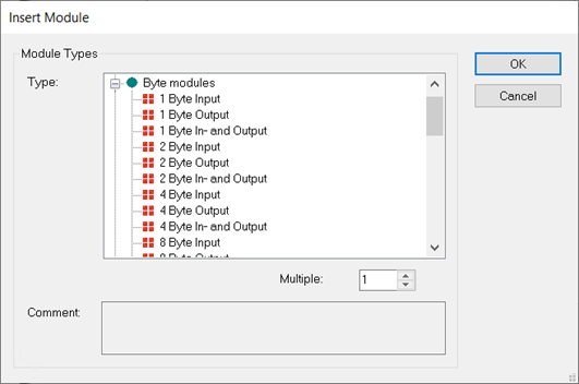

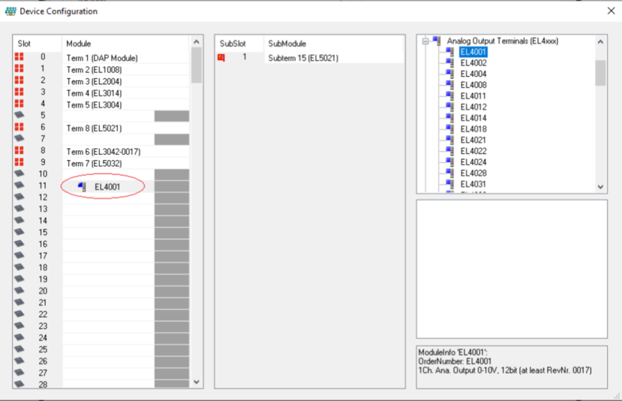

The slots and subslots can be populated simply by double-clicking or via drag and drop.

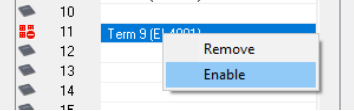

In the slot and subslot list, populated modules or submodules can be disabled via the context menu (right mouse click).
From TwinCAT Version 3.1 Build 4024 4:
The icon indicates disabled status, which is also apparent in the module tree. Disabled objects are ignored during project planning, i.e. corresponding slots or subslots are considered empty.

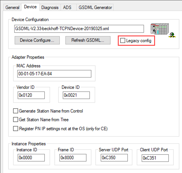

It is possible to switch to classic tree view for module/submodule population, if required.
From TwinCAT Version 3.1 Build 4024 5:
To do this, check Legacy Config on the Device tab of the attached box.
