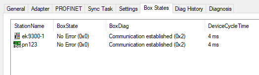

Box States
Directly below the PROFINET controller protocol there is a collective PROFINET error and a collective PROFINET status. Both show the number of devices for which a problem has occurred or for which a diagnosis is available. The error indicates possible problems with the connection establishment or reasons for a termination. The diagnosis provides status information about an existing connection.
Box States 1:
PnIoError - number of PROFINET IO devices that have an error
PnIoDiag - number of PROFINET IO devices where a diagnosis is available
It is possible to check at a glance which device or box has a problem in the protocol under Box States.
