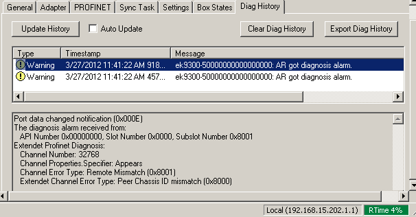

The information content of the structure corresponds to that of the Diag History, which is displayed in the system manager.
ST_PN_Diag 1:Fig.25: "Diag History" tab
