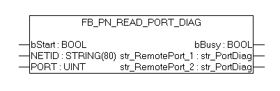

FUNCTION_BLOCK FB_PN_READ_PORT_DIAG
FUNCTION_BLOCK FB_PN_READ_PORT_DIAG 1:Fig.22: FUNCTION_BLOCK FB_PN_READ_PORT_DIAG
This block calls the port diagnostic information of a PROFINET device.
    bStart      : BOOL;
    NETID   : T_AmsNetId;(* AMS Net ID from Controller *)
    PORT    : T_AmsPort; (* Port used by Controller to communicate with Device *)
bStart: The function block is activated by a positive edge at this input
NETID: AMS Net ID of the controller
PORT: Port via which the controller communicates with the device (port = Device ID + 1000 hex)
    bBusy       : BOOL;
    str_RemotePort_1    : str_PortDiag;
    str_RemotePort_2    : str_PortDiag;
bBusy: When the function block is activated this output is set. It remains set until a feedback is received. While Busy = TRUE, no new command will be accepted at the inputs.
str_RemotePort_1: This structure contains the diagnostic information for Port 1.
str_RemotePort_2: This structure contains the diagnostic information for Port 2.
