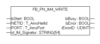

FUNCTION_BLOCK FB_PN_IM4_WRITE
Fig.20: FUNCTION_BLOCK FB_PN_IM4_WRITEUsing this function block the PROFINET controller writes all I&M4 data (Identification & Maintenance) data to a device referenced via the Port input.
The frame structure of the I&M4 function corresponds to the index 0xAFF4 according to PROFINET standard.
bStart : BOOL;
NETID : T_AmsNetId;(* AMS Net ID from Controller *)
PORT : T_AmsPort; (* Port used by Controller to communicate with Device *)
st_IM_Signatur : STRING(54);
END_VARbStart: The function block is activated by a positive edge at this input
NETID: AMS Net ID of the controller
PORT: Port via which the controller communicates with the device (port = Device ID + 1000 hex)
st_IM_Signatur: Signature of the manufacturer is written to the device.
bBusy : BOOL;
bError : BOOL;
iErrorID : UDINT;
END_VARbBusy: When the function block is activated this output is set. It remains set until a feedback is received. While Busy = TRUE, no new command will be accepted at the inputs.
bError: In the event of an error during the command transfer, this output is set once the bBusy output has been reset.
iErrorID: Supplies an ADS error number when the output bError is set.
