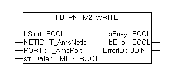

FUNCTION_BLOCK FB_PN_IM2_WRITE
Fig.16: FUNCTION_BLOCK FB_PN_IM2_WRITEUsing this function block the PROFINET controller writes all I&M 2 data (Identification & Maintenance) data to a device referenced via the Port input.
The frame structure of the I&M2 function corresponds to the index 0xAFF2 according to PROFINET standard.
bStart : BOOL;
NETID : T_AmsNetId;(* AMS Net ID from Controller *)
PORT : T_AmsPort; (* Port used by Controller to communicate with Device *)
str_Date : TIMESTRUCT;(*YYYY-MM-DD HH:MM*)
END_VARbStart: The function block is activated by a positive edge at this input
NETID: AMS Net ID of the controller
PORT: Port via which the controller communicates with the device (port = Device ID + 1000hex)
str_Date : Writes a date (e.g. date of installation of the device) to the device in the format < YYYY-MM-DD HH:MM >.
bBusy : BOOL;
bError : BOOL;
iErrorID : UDINT;
END_VARbBusy: When the function block is activated this output is set. It remains set until a feedback is received. While Busy = TRUE, no new command will be accepted at the inputs.
bError: If an error should occur during the transmission of the command, this output is set after the bBusy output has been reset.
iErrorID: Supplies an ADS error number when the output bError is set.
