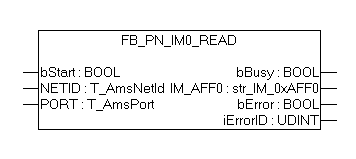

FUNCTION_BLOCK FB_PN_IM0_READ
FUNCTION_BLOCK FB_PN_IM0_READ 1:Fig.12: FUNCTION_BLOCK FB_PN_IM0_READ
Using this function block the PROFINET controller reads all I&M 0 data (Identification & Maintenance) from a device referenced via the Port input.
The frame structure of the I&M0 function corresponds to the index 0xAFF0 according to PROFINET standard.
    bStart  : BOOL;
    NETID   : T_AmsNetId;(* AMS Net ID from Controller *)
    PORT    : T_AmsPort; (* Port used by Controller to communicate with Device *)
bStart: The block is activated by a rising edge on this input
NETID:    AMS Net ID des Controllers
PORT:     Port via which the controller communicates with the device (port = Device ID + 1000 hex)
    bBusy   : BOOL;
    IM_AFF0 : str_IM_0xAFF0;
    bError  : BOOL;
    iErrorID    : UDINT;
bBusy: When the function block is activated this output is set. It remains set until a feedback is received. While Busy = TRUE, no new command will be accepted at the inputs.
IM_AFF0: Output of the I&M0 frame supplied by the device in a structure. str_IM_0xAFF0.
bError: In the event of an error during the command transfer, this output is set once the bBusy output has been reset.
iErrorID: Supplies an ADS error number when the output bError is set.
