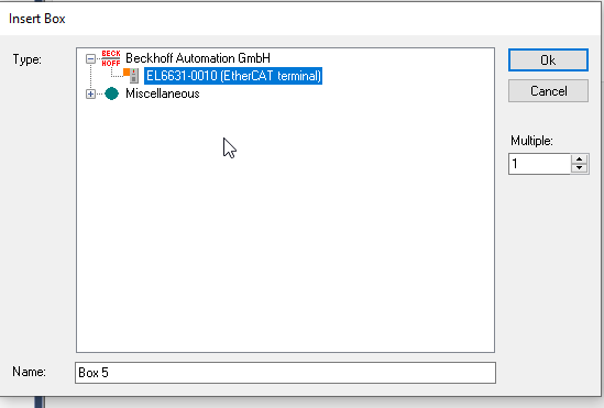

The following section shows how to configure a PROFINET device using the PROFINET Gateway Terminal EL6631-0010 or EL6633-0010, hereinafter referred to as EL663x-0010.
The EL663x-0010 is primarily an EtherCAT slave, which means that it must be included in the TwinCAT configuration because it serves as an adapter for the PROFINET device. As a result, if the EtherCAT bus has an error, the PROFINET adapter will also display errors and therefore will not work.

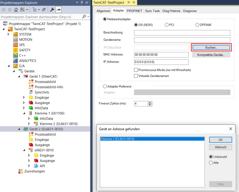

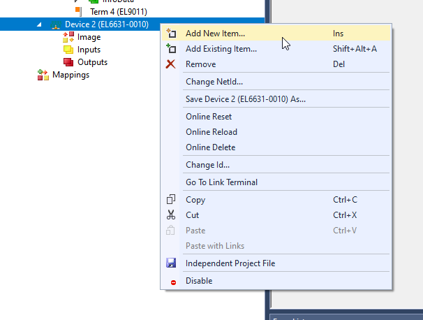

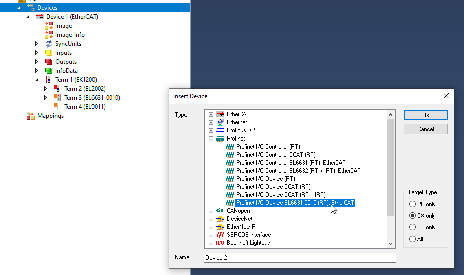

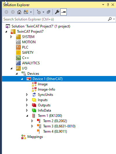

Integration via an EL663x-0010 1:Fig.11: EL663x-0010 in the TwinCAT tree
Integration via an EL663x-0010 4:Fig.14: Modifications -> "Adapter" tab

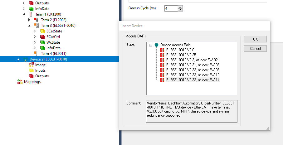

Next, a box is integrated in the form of a GSDML.
Integration via an EL663x-0010 7:Fig.17: Choice of version of the EL663x-0010
