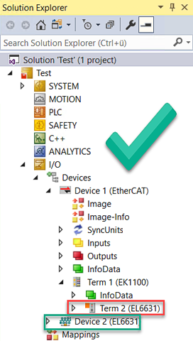

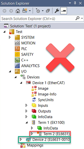

- Was the correct terminal used?
- EL6631-0010 cannot be used as controller

Fig.23: Wrong configuration
Fig.24: Correct configuration
