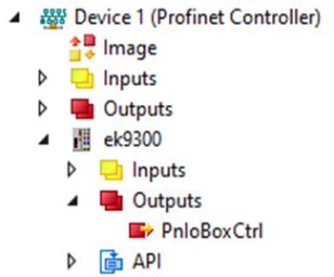

PnIoBoxCtrl
PnIoBoxCtrl can be used for assigning names; only the low byte is to be used for this. The high byte must be 0x00.
PnIoBoxCtrl | Comment | Meaning |
0x0001 | EBusReset | EBusReset on the EK9300/EP9300 |
