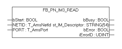

FUNCTION_BLOCK FB_PN_IM3_READ
FUNCTION_BLOCK FB_PN_IM3_READ 1:
Using this function block the PROFINET controller reads all I&M3 data (Identification & Maintenance) from a device referenced via the Port input.
The frame structure of the I&M3 function corresponds to the index 0xAFF3 according to PROFINET standard.
    bStart  :
    BOOL; NETID   : T_AmsNetId;(* AMS Net ID from Controller *)
    PORT    : T_AmsPort; (* Port used by Controller to communicate with Device *)
bStart: The function block is activated by a positive edge at this input
NETID: AMS Net ID of the controller
PORT: Port via which the controller communicates with the device (port = Device ID + 1000 hex)
    bBusy       : BOOL;
    st_IM_Descriptor    : STRING(54);
    bError      : BOOL;
    iErrorID        : UDINT;
bBusy: When the function block is activated this output is set. It remains set until a feedback is received. While Busy = TRUE, no new command will be accepted at the inputs.
st_IM_Descriptor: Returns the manufacturer description stored for the device.
bError: In the event of an error during the command transfer, this output is set once the bBusy output has been reset.
iErrorID: Supplies an ADS error number when the output bError is set.
