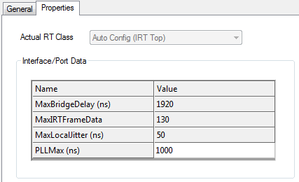

The type of communication can always be set on the interface submodel (at present RTClass1 or RTClass3). The only exception is in the case that a generally valid RTClass was set via the ‘Auto Config...’ menu.
If communication takes place over RTClass3, then the PLL window can additionally be set at the interface.
