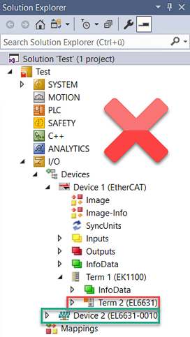

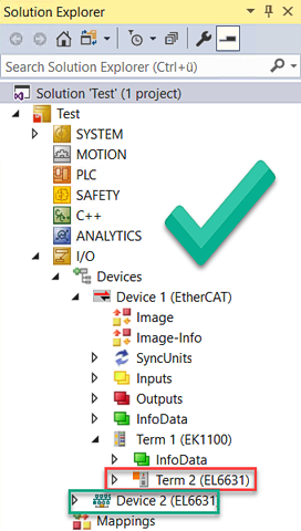

- Was the correct terminal used?
- EL663x-0000 cannot be used as device
- EL6631-0010 cannot be used as controller
