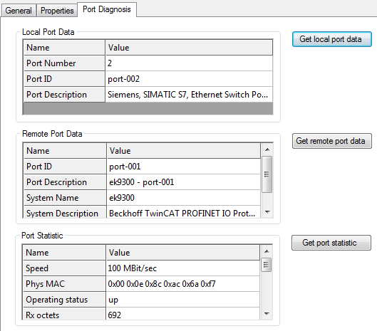

Port-specific settings can be made on the ‘Properties’ tab. The menu of possible settings always depends on the RTClass employed.
Fig.42: "Properties" tabIn addition some port properties can be read out.
