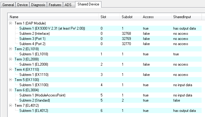

The dialogue appears if the device supports "SharedDevice". The information for this comes from the GSDML.
Shared Device 1:Fig.40: "Shared Device" tab
There is an option here to allow or forbid the controller to access the individual sub-modules. By default the controller may access all sub-modules; if SharedInput is supported it is switched off.
The text messages for SharedInput have the following meanings:
The settings can be changed by double-clicking on the individual sub-modules. If the access to a port or interface sub-module is changed, then it is changed for all ports or interfaces.
