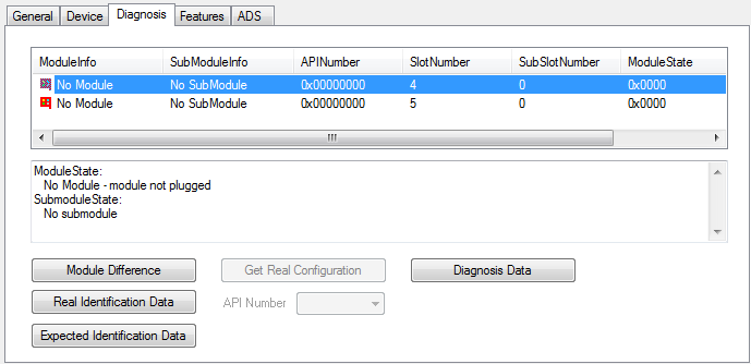

Comparison of nominal and actual configuration

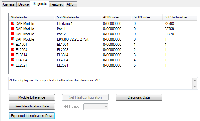

If a connection exists, the project planning can be checked on the “Diagnosis” tab. At this level “Real Identification Data” returns the actually existing modules in an AR, “Expected Identification Data” indicates the expected modules (i.e. those projected in the controller) and “Module Difference” shows the differences to the device found in the nominal-actual comparison.

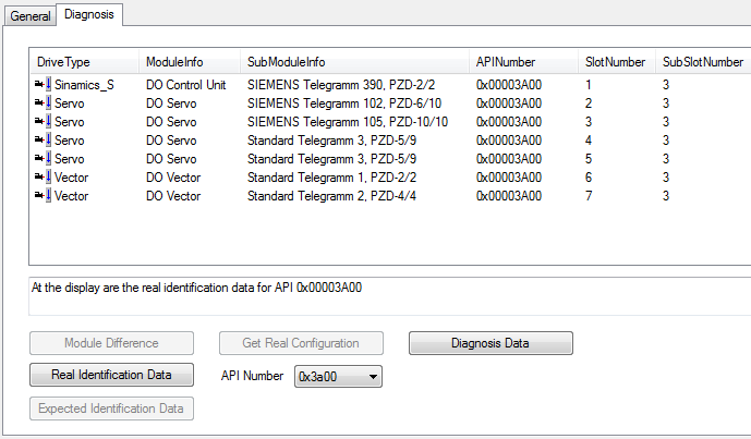

Fig.33: "Diagnosis" tab, checking the project planning If you are on the “Diagnosis” tab within the API, you can select the corresponding API about which information is to be obtained. If, for example, the PROFINET device is a drive, then this usually supports the Profidrive profile, which is identified in turn via API 0x3A00. If the Real Identification Data is to be read from this API, for example, then this access takes place via the Profidrive profile.
Fig.34: "Diagnosis" tab, API selectionIn addition, the “Get Real Configuration” button becomes active within an API (except for drives). It is possible via this to adopt the read-in data record into the current project. Note that modules that have already been created will be overwritten when doing this. This means that the links are lost, even in the case of previously correctly created modules.
When displaying the module differences, additional information is displayed by marking the message.

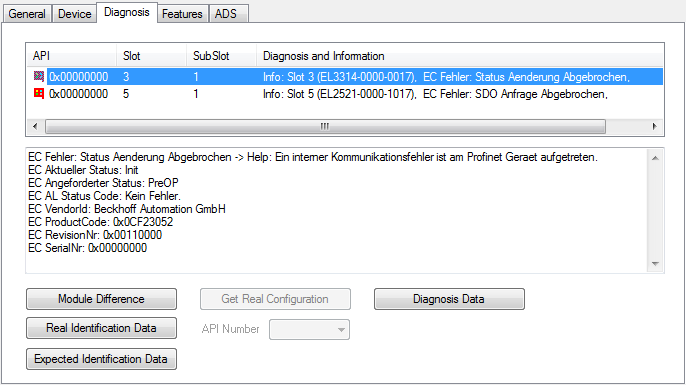

The available diagnosis can be read out by pressing the “Diagnosis Data” button. At device level all available diagnosis data for the existing AR is read out here.
Fig.36: "Diagnosis", Button Diagnosis DataA maximum of two diagnosis parameters are displayed in the list; others are marked by “…”. If the individual message is clicked, all available diagnosis information is displayed in the window below.
