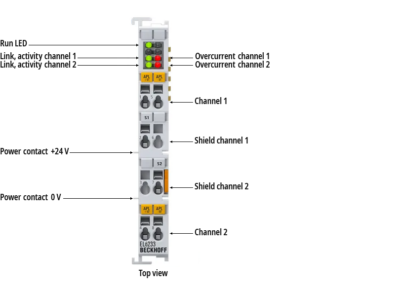

EL6233 - Introduction 1:Fig.1: EL6233 | Two channel communication interface, Ethernet-APL
The EL6233 EtherCAT Terminal allows direct connection of Ethernet-APL-capable field devices. The sensors are supplied in accordance with the SPCX port profile and integrated via PROFINET. Thanks to the flexible EtherCAT system architecture and the EL portfolio, Ethernet-APL, HART or simple digital signals can be integrated in the same terminal segment
