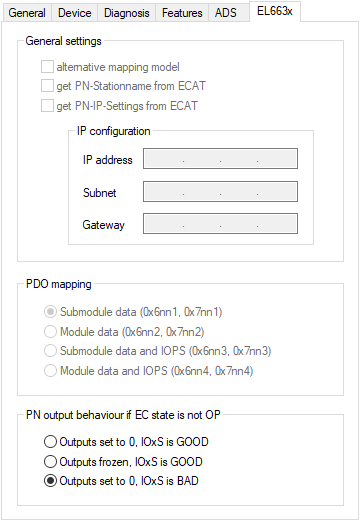

EL663x
If the controller protocol is operated via an EL663x, then an additional menu appears on the devices.
Fig.39: "EL663x" tabCurrently only the PDO mapping can be selected for the controller. This sets the form in which the PROFINET process data are mapped to the EtherCAT-side PDOs.
