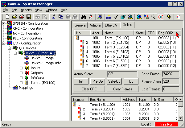

Determining the version via the TwinCAT System Manager
The TwinCAT System Manager indicates the FPGA firmware version. Click on the Ethernet card of your EtherCAT strand (Device 2 in the example) and select the Online tab.
The Reg:0002 column indicates the firmware version of the individual EtherCAT devices in hexadecimal and decimal representation.
Fig.187: FPGA firmware version definition If the column Reg:0002 is not displayed, right-click the table header and select Properties in the context menu.

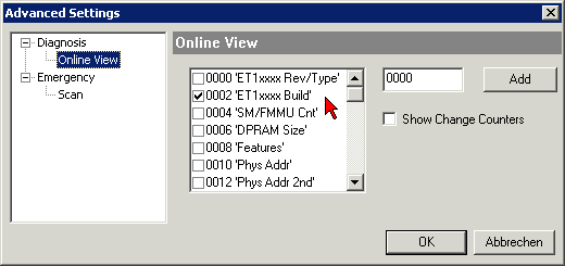

Fig.188: Context menu Properties The Advanced Settings dialog appears where the columns to be displayed can be selected. Under Diagnosis/Online View select the '0002 ETxxxx Build' check box in order to activate the FPGA firmware version display.

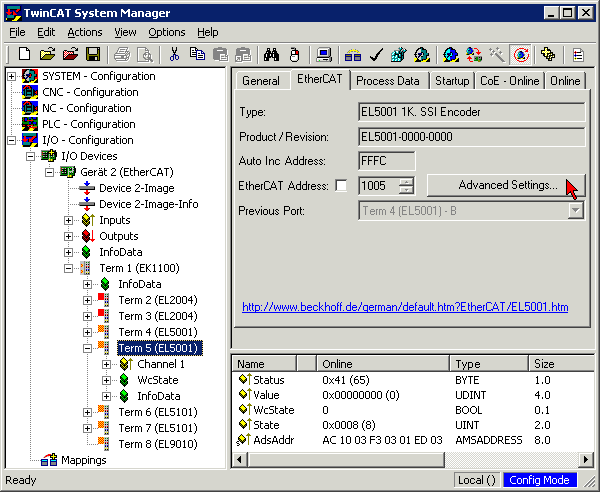

- Switch TwinCAT system to ConfigMode/FreeRun with cycle time >= 1 ms (default in ConfigMode is 4 ms). A FW-Update during real time operation is not recommended.
 - In the TwinCAT System Manager select the terminal for which the FPGA firmware is to be updated (in the example: Terminal 5: EL5001) and
click the Advanced Settings button in the EtherCAT tab:

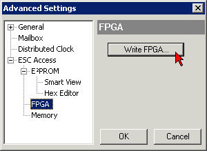

 - The Advanced Settings dialog appears. Under ESC Access/E²PROM/FPGA click on Write FPGA button:

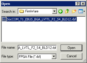

 - Select the file (*.rbf) with the new FPGA firmware, and transfer it to the EtherCAT device:
 - Wait until download ends
