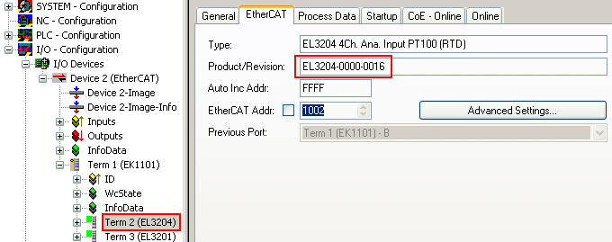

The ESI device description is stored locally on the slave and loaded on start-up. Each device description has a unique identifier consisting of slave name (9 characters/digits) and a revision number (4 digits). Each slave configured in the System Manager shows its identifier in the EtherCAT tab:
Fig.179: Device identifier consisting of name EL3204-0000 and revision -0016 The configured identifier must be compatible with the actual device description used as hardware, i.e. the description which the slave has loaded on start-up (in this case EL3204). Normally the configured revision must be the same or lower than that actually present in the terminal network.

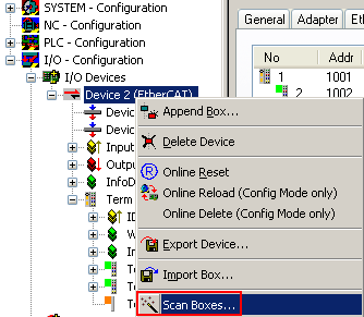

The simplest way to ascertain compliance of configured and actual device description is to scan the EtherCAT boxes in TwinCAT mode Config/FreeRun:
Fig.180: Scan the subordinate field by right-clicking on the EtherCAT deviceIf the found field matches the configured field, the display shows

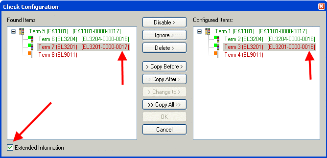

Fig.181: Configuration is identical otherwise a change dialog appears for entering the actual data in the configuration.
Fig.182: Change dialog In this example in Fig. Change dialog, an EL3201-0000-0017 was found, while an EL3201-0000-0016 was configured. In this case the configuration can be adapted with the Copy Before button. The Extended Information checkbox must be set in order to display the revision.

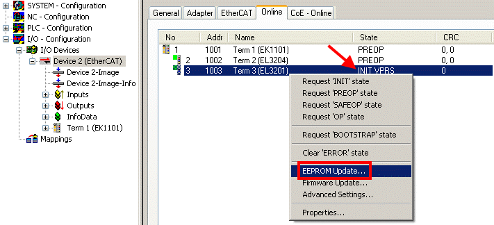

 - Right-clicking on the slave in the online display opens the EEPROM Update dialog, Fig. EEPROM Update

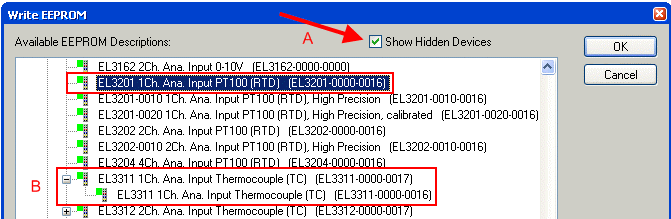

Fig.183: EEPROM Update The new ESI description is selected in the following dialog, see Fig. Selecting the new ESI. The checkbox Show Hidden Devices also displays older, normally hidden versions of a slave.
Fig.184: Selecting the new ESIA progress bar in the System Manager shows the progress. Data are first written, then verified.
