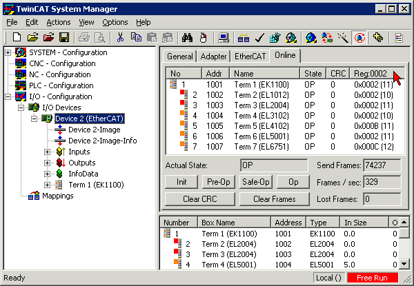

The TwinCAT System Manager indicates the FPGA firmware version. Click on the Ethernet card of your EtherCAT strand (Device 2 in the example) and select the Online tab.
The Reg:0002 column indicates the firmware version of the individual EtherCAT devices in hexadecimal and decimal representation.
 Fig.141: FPGA firmware version definition
Fig.141: FPGA firmware version definition If the column Reg:0002 is not displayed, right-click the table header and select Properties in the context menu.

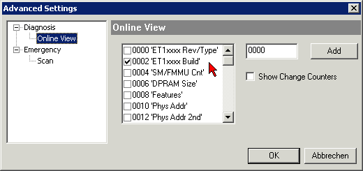

Fig.142: Context menu Properties The Advanced Settings dialog appears where the columns to be displayed can be selected. Under Diagnosis/Online View select the '0002 ETxxxx Build' check box in order to activate the FPGA firmware version display.
 Fig.143: Dialog Advanced Settings
Fig.143: Dialog Advanced Settings Update

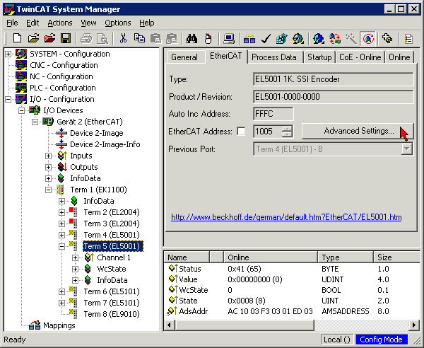

- In the TwinCAT System Manager select the terminal for which the FPGA firmware is to be updated (in the example: Terminal 5: EL5001) and
 click the Advanced Settings button in the EtherCAT tab:

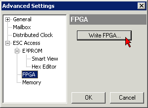

- The Advanced Settings dialog appears. Under ESC Access/E²PROM/FPGA click on Write FPGA button:

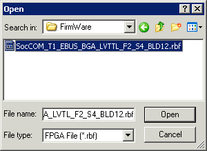

- Select the file (*.rbf) with the new FPGA firmware, and transfer it to the EtherCAT device:
- Wait until download ends
