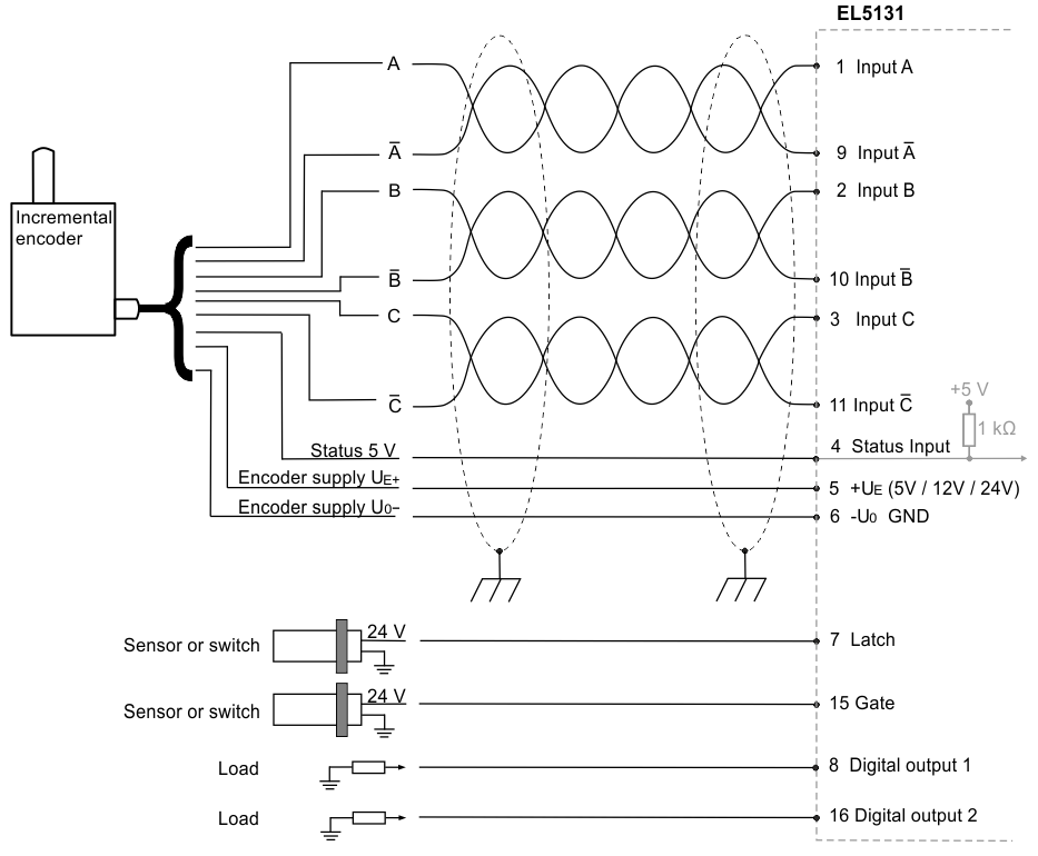

Connection of RS422 encoders with or without zero pulse
RS422 mode 1:
Connection encoder RS422 mode with zero pulse
RS422 mode 2:
Connection instructions
  • When using an encoder without zero pulse C, the terminal points for the C track are not connected.

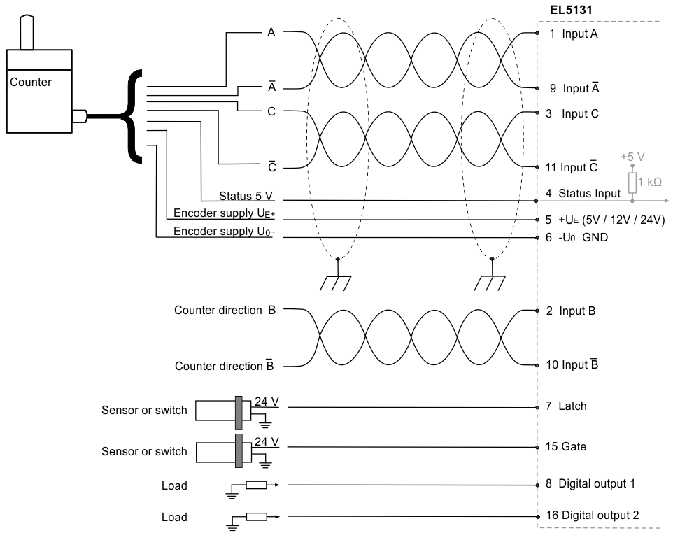

Connection of RS422 counters / pulse generators with or without zero pulse
RS422 mode 3:
Connection counter / pulse generator RS422 mode with zero pulse
RS422 mode 4:
  • When a counter/pulse generator is connected, the B track specifies the counting direction.
    In RS422 mode, a differential signal is expected on the B̅ track.
  • When using a counter / pulse generator without zero pulse C, the terminal points for the C track are not connected.
