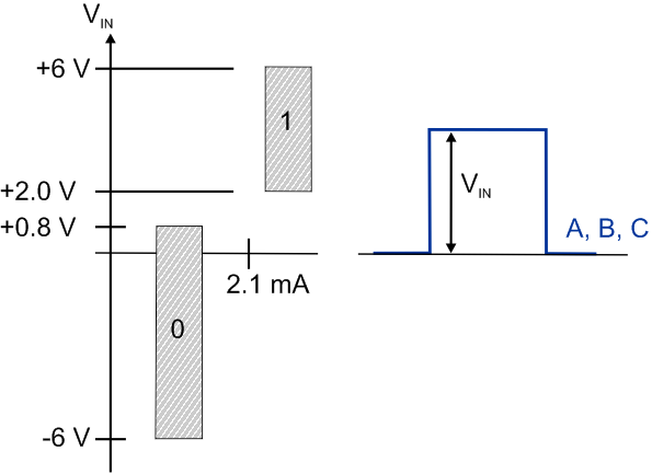

Signal type TTL (single-ended) and Open Collector
With the following settings in "Counter mode" (0x80n1:1D), a voltage level of nominally 2.0 V to 6.0 V with a current of 2.1 mA or higher is expected:
For TTL encoders a cut-off frequency of up to 4 million increments per second is permissible with 4-fold evaluation. This corresponds to 1 MHz.
For Open Collector encoders, a cut-off frequency of up to 400,000 increments per second is permissible with 4-fold evaluation. This corresponds to 100 kHz.
Signal type TTL (single-ended) and Open Collector 1:Fig.5: TTL, Open Collector signal level (single-ended signal)
Key:
VIN
Single-ended input voltage
A, B, C
Encoder signals A, B, C
