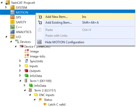

Adding a Motion element
Right-click Motion
Select Add New Item... in the pull-down menu (Fig. Motion, add item).

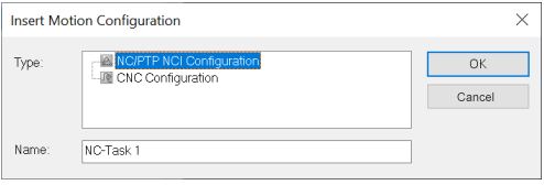

Fig.133: Motion, add itemSelect the configuration type NC/PTP NCI Configuration.
Name the task and confirm with OK (Fig. Select type, name and confirm task)

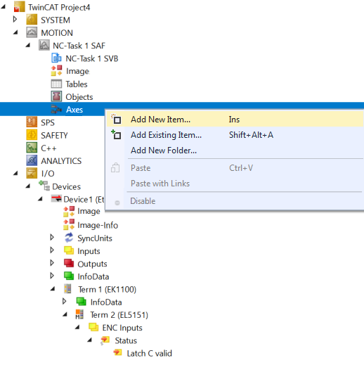

Right-click Axes
Select Add New Item in the pull-down menu (Fig. Insert axis).
Fig.135: Insert axisChoose a name for the axis
Select the Encoder axis type and confirm with OK (Fig. Naming the axis and selecting the type)

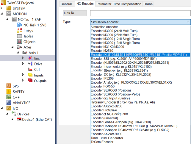

After selecting the NC Encoder tab select Encoder (KL5101/Kl5111/IP5109/EL5101/EL5151/Profile MDP 511) in the Type pull-down menu (Fig. Selecting the encoder)
Click the button Linked to...

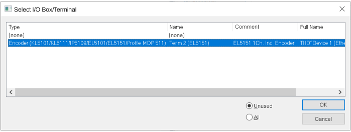

Fig.137: Selecting the encoderSelect the EL5151 terminal and confirm with OK (Fig. Select and confirm the encoder terminal)
Fig.138: Selecting and confirming an encoder terminalDisplay of the linked inputs and outputs
